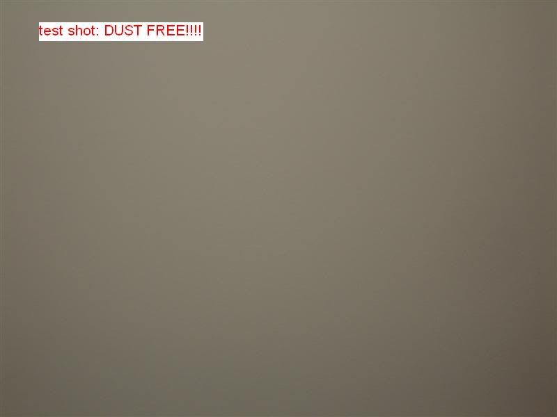

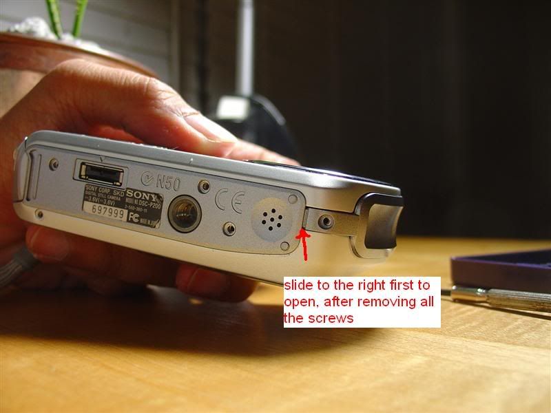

I opened P200 successfully to remove dust from sensor!!!
Started Apr 14, 2006 | Discussions thread
OP mamkho New Member • Posts: 6
Re: I opened P200 successfully to remove dust from sensor!!!

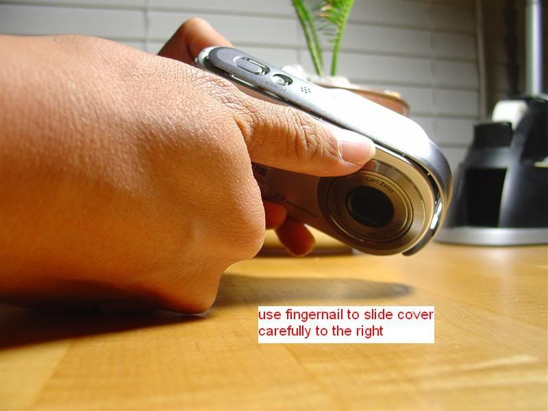

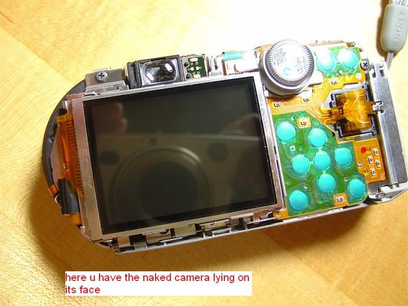

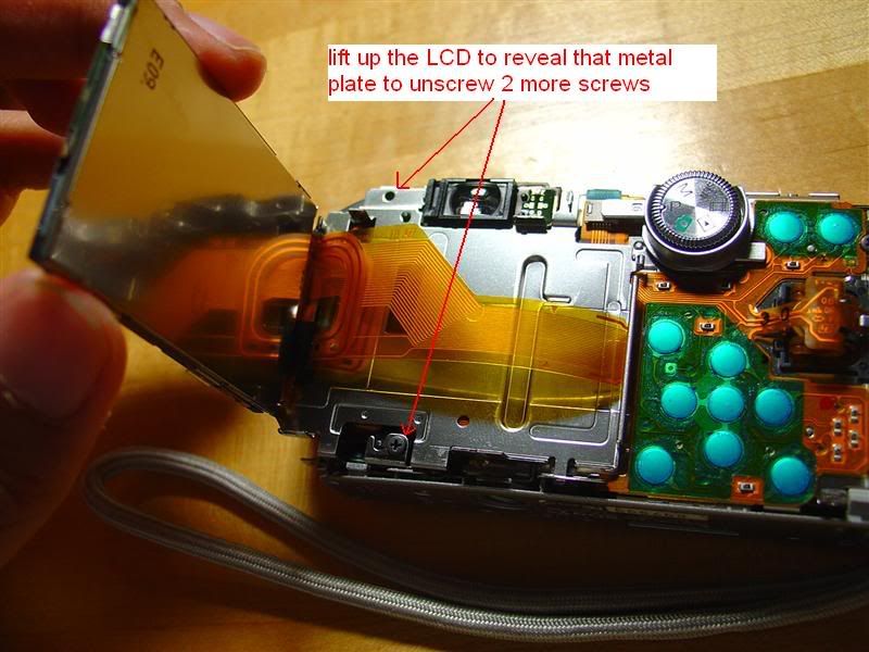

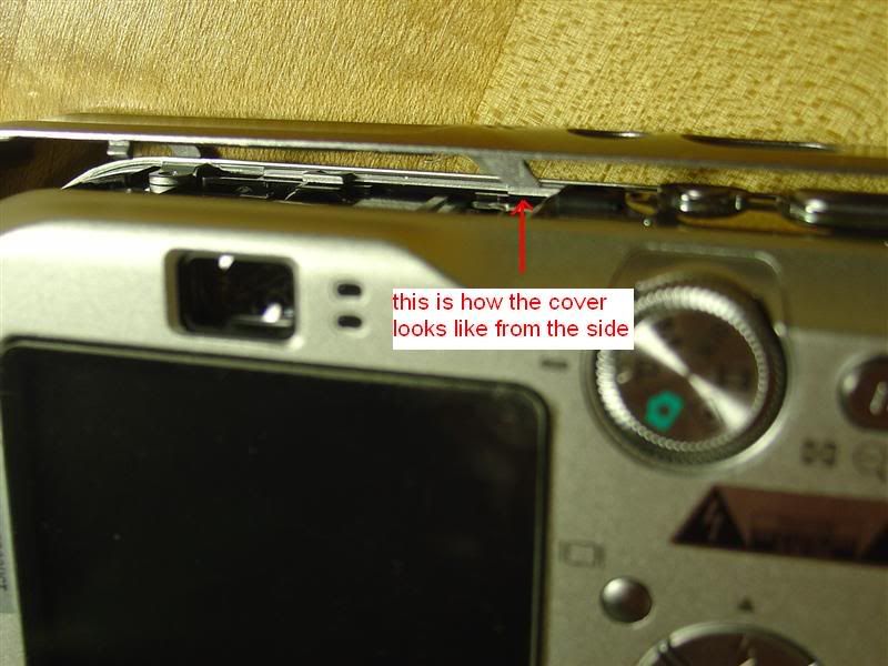

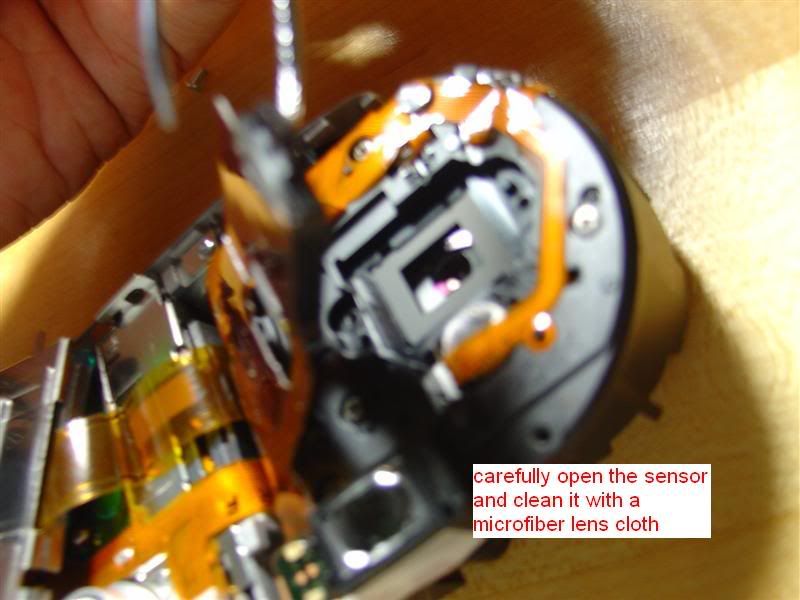

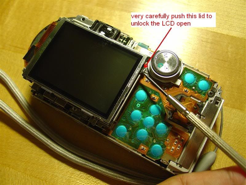

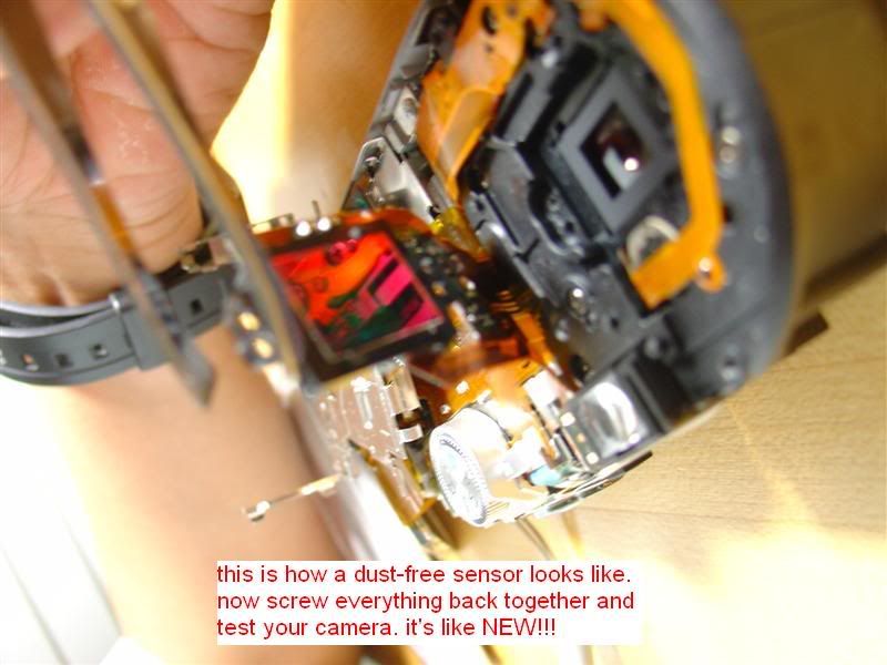

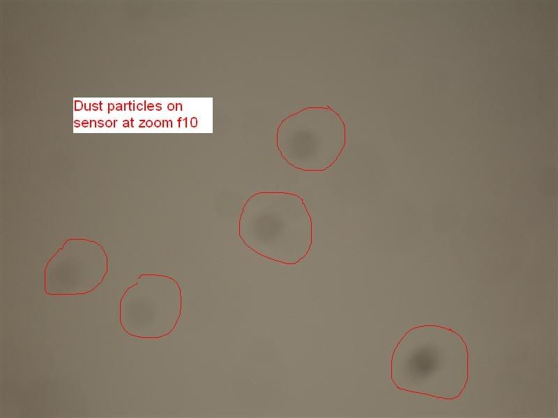

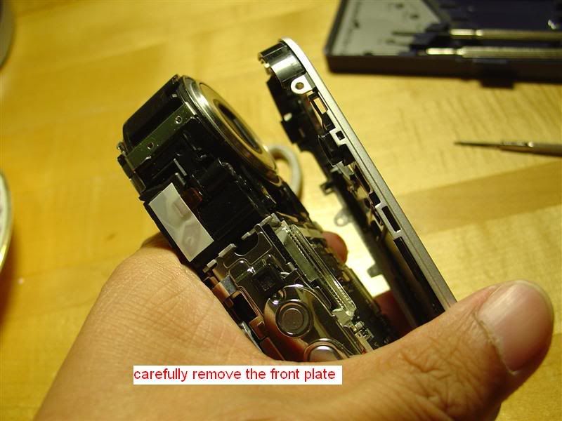

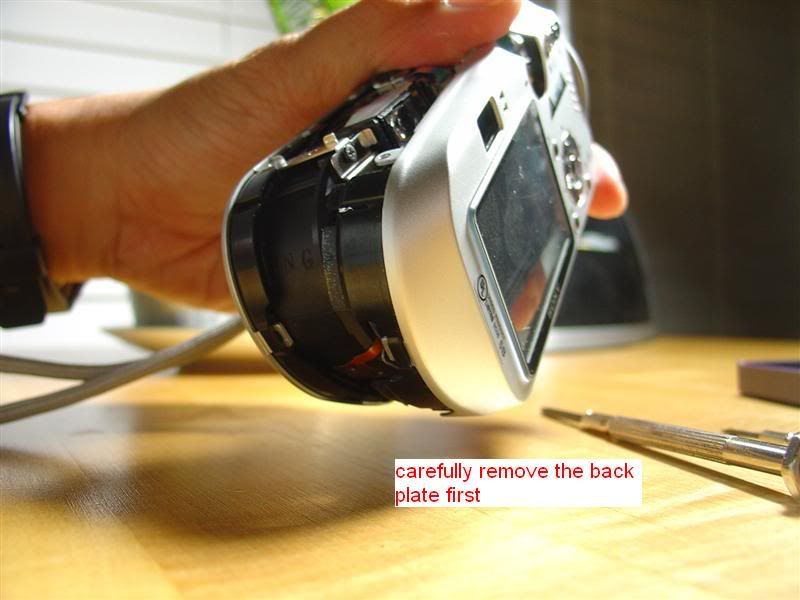

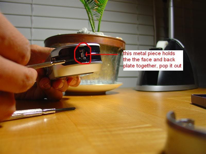

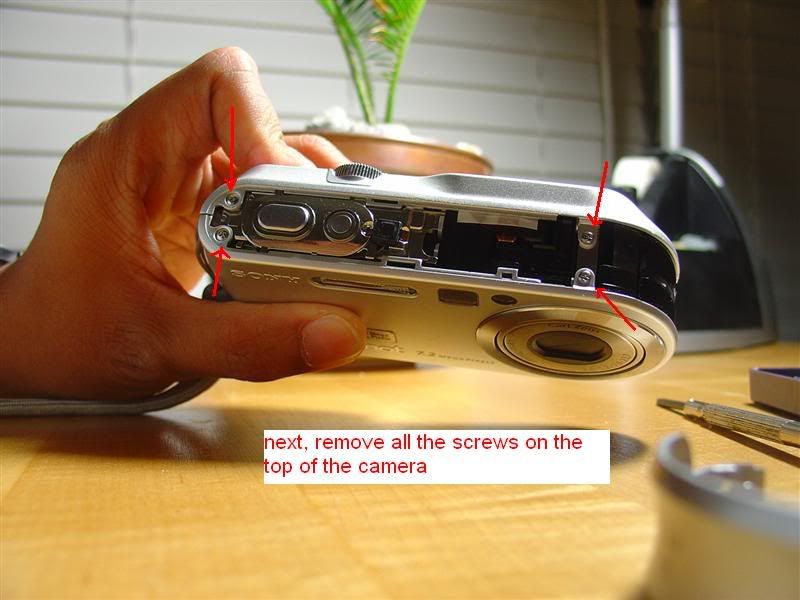

here's a guide (my personal) to remove the dust off the sensor of your SONY DSC-P200 without having to send in your camera and paying ridiculous amounts of money. i hope it helps. btw: during the whole procedure i had the battery as well as the memory stick in the camera. but u can remove it if u want. please let me know how it goes. GOOD LUCK!!!
