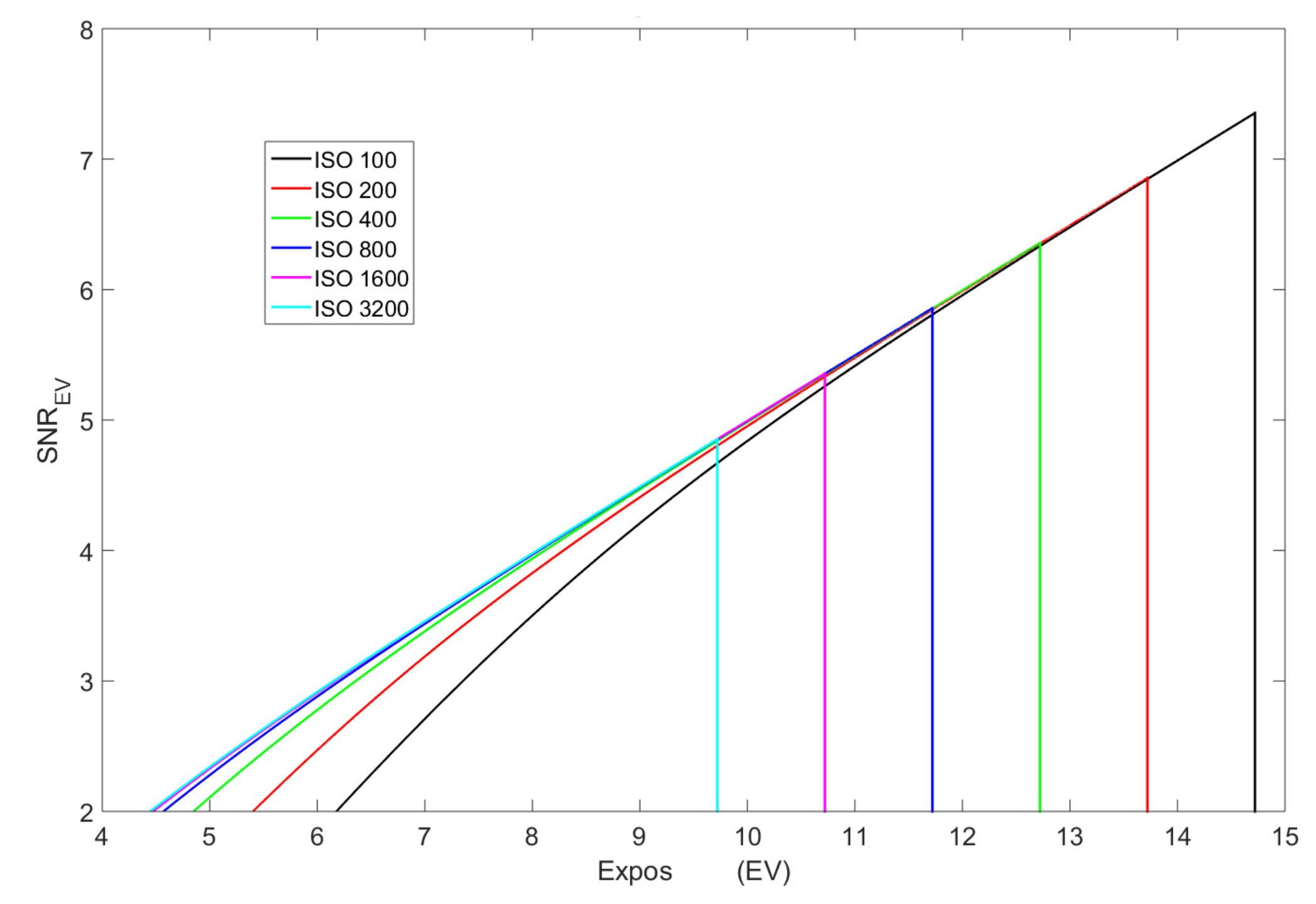

Separating out these elements helps us eliminate another error: that amplification or some aspect of the camera's electronics increase noise when you raise the ISO level. In most circumstances, it's the reduction in exposure that increases the noise, because it means you're capturing less light and are more likely to see how random and noisy the light itself is.

The latest update to the ISO standard makes it explicit that it does not apply to Raw files. Until a tone curve is applied, a Raw file doesn't have a 'middle grey': it's up to the manufacturer to decide which Raw value should be used. Consequently, there isn’t a specific Raw value you can measure or check for correct lightness, so you can't measure the ISO (or ISO accuracy) of a Raw file.
If you’re ever seen graphs plotting ‘Measured ISO’ against ‘Manufacturer ISO,’ then you risk being misled.
If you’re ever seen graphs of ‘Measured ISO’ plotted against ‘Manufacturer ISO,’ then you risk being misled. What they show is how a camera’s ISO settings are delivered, relative to an arbitrary system that assumes Raw files will saturate at a certain exposure. You can often work out how amplification is being applied using these graphs, but they do not show ISO accuracy, since the ISO standard doesn’t define a relationship between exposure and Raw saturation.
