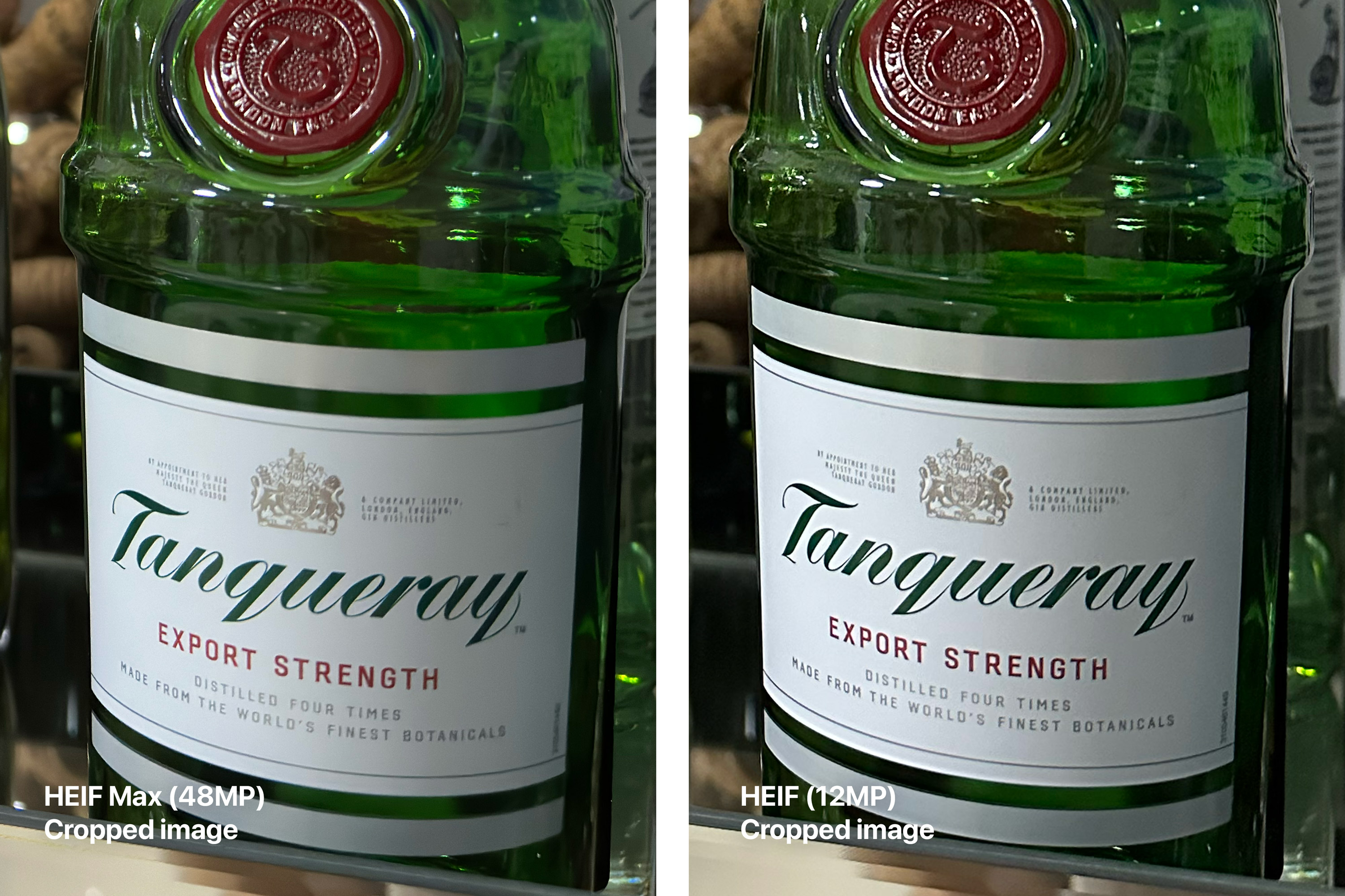

Capturing higher dynamic range 48MP Raw images is still a premium feature reserved for the Pro models, but now every iPhone 15 device can also record 48MP HEIF (or JPEG if you opt for "Most Compatibility" in the Camera Capture settings) files. In an odd choice of terminology crossover, Apple calls the 48 MP option ‘HEIF Max’ or ‘RAW Max’ - so you can shoot in RAW Max on your iPhone 15 Pro Max or in HEIF Max on your iPhone 15 Plus. Too many superlatives!
There’s good news here for iPhone 14 Pro owners who upgrade to iOS 17: with the 48MP sensor onboard, you can also choose to capture 48MP HEIF images, which average around 5MB in size compared to the 75MB size for ProRAW files at the maximum resolution.
48 megapixels is no longer limited to Raw files. The main camera sensor's full resolution can be captured as HEIF or JPEG files (left). Quickly switch between modes by pressing the format button (right); the 'RAW 12' refers to Raw format at 12MP on the iPhone 14 Pro.
