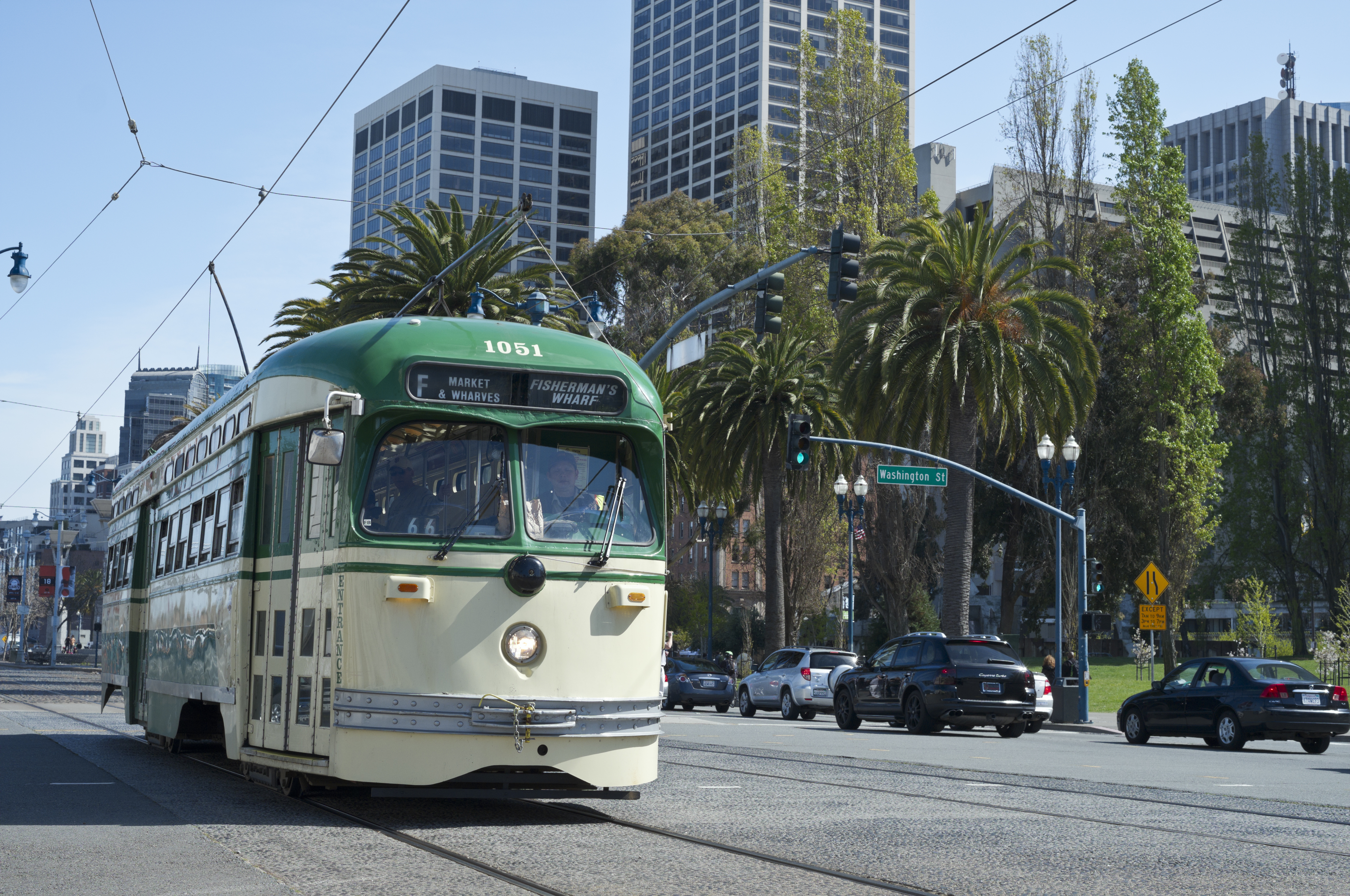

Adobe Camera Raw support
Adobe was one of the first third-party software makers to provide Raw support for the Fujifilm X-Pro1, but the results have not always lived up to the standard set by the camera's JPEG engine, when it comes to rendering fine detail.
ACR vs Camera JPEG
Adobe Camera Raw - Default settings | Camera JPEG - default settings |
100% Crop | 100% Crop |
In the ACR-converted files, the foliage files takes on something of a 'watercolor' appearance, and the white text of the sign is 'filled-in' green. However the differences in detail rendition aren't pronounced, even at 100%. They become more apparent at even greater levels of magnification but the degree to which this is relevant is arguable. It's interesting to note that this brushstroke effect is exaggerated by applying more luminance noise reduction to files in ACR.

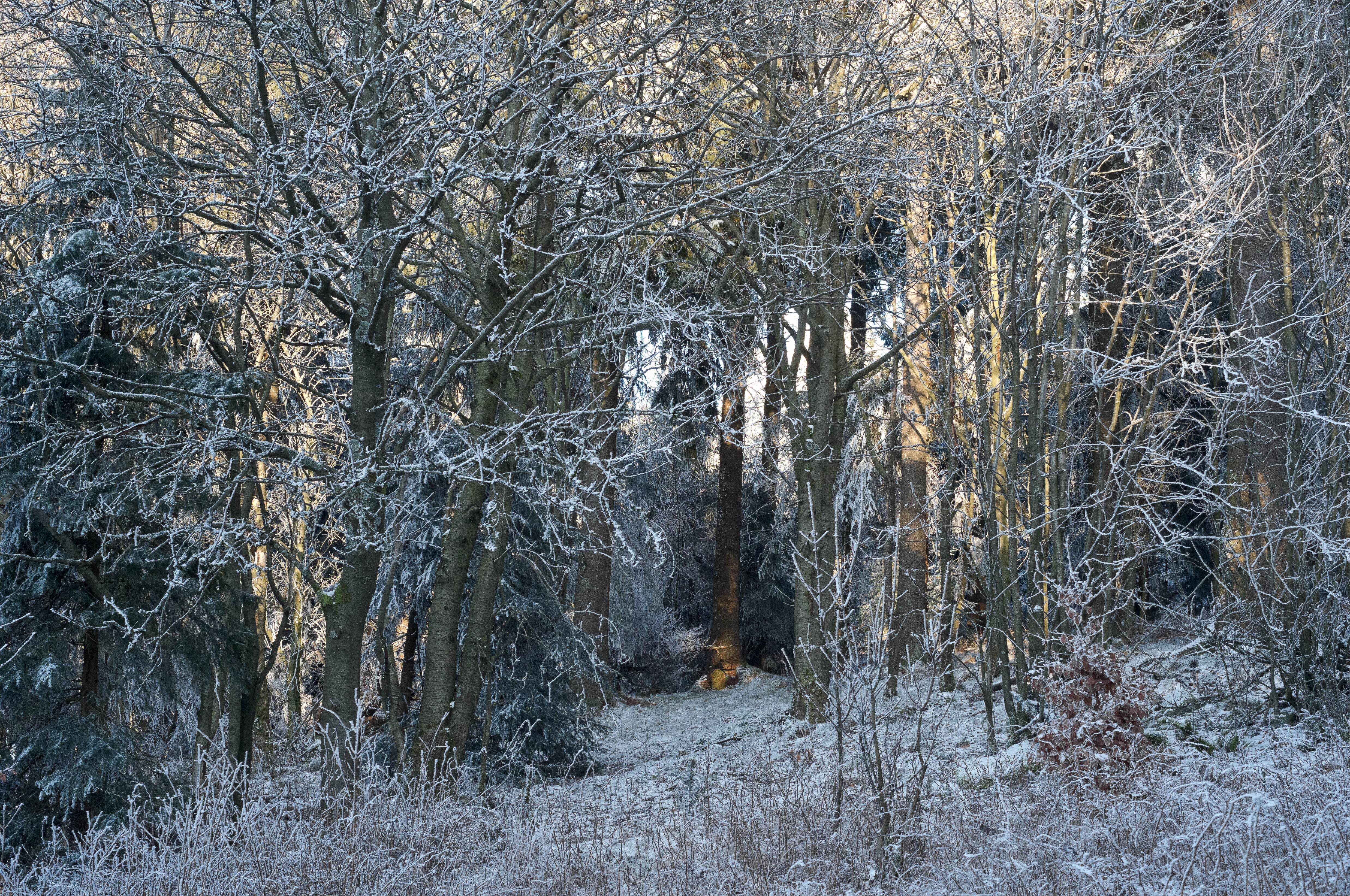

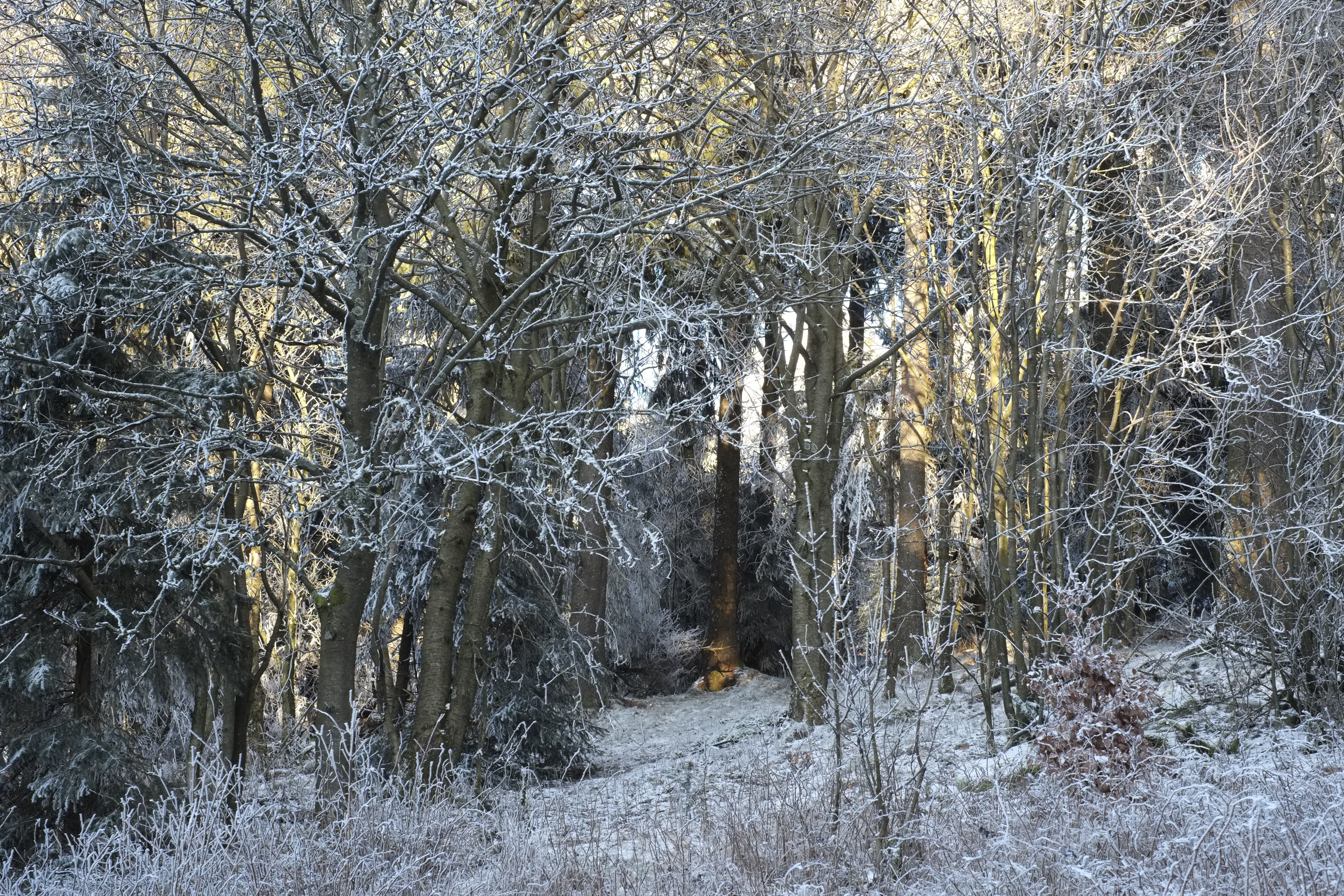

Capture One v7.0.2 - default settings vs Camera JPEG
As you can see, Capture One's color response is much closer to the camera's results than Adobe's default profile. The default results are also substantially more sharpened than the JPEGs are. In comparison with the camera JPEGs, there are hints of the same brushstroke effect that Adobe Camera Raw produces, though not to the same degree and mitigated, perhaps, by the better color response.
Capture One 7.0.2 beta - default settings | Camera JPEG - default settings |
100% Crop |
It's noticeable that Capture One is less prone to color errors than Adobe Camera Raw, but struggles with the moiré that Adobe appears to be trying to avoid.

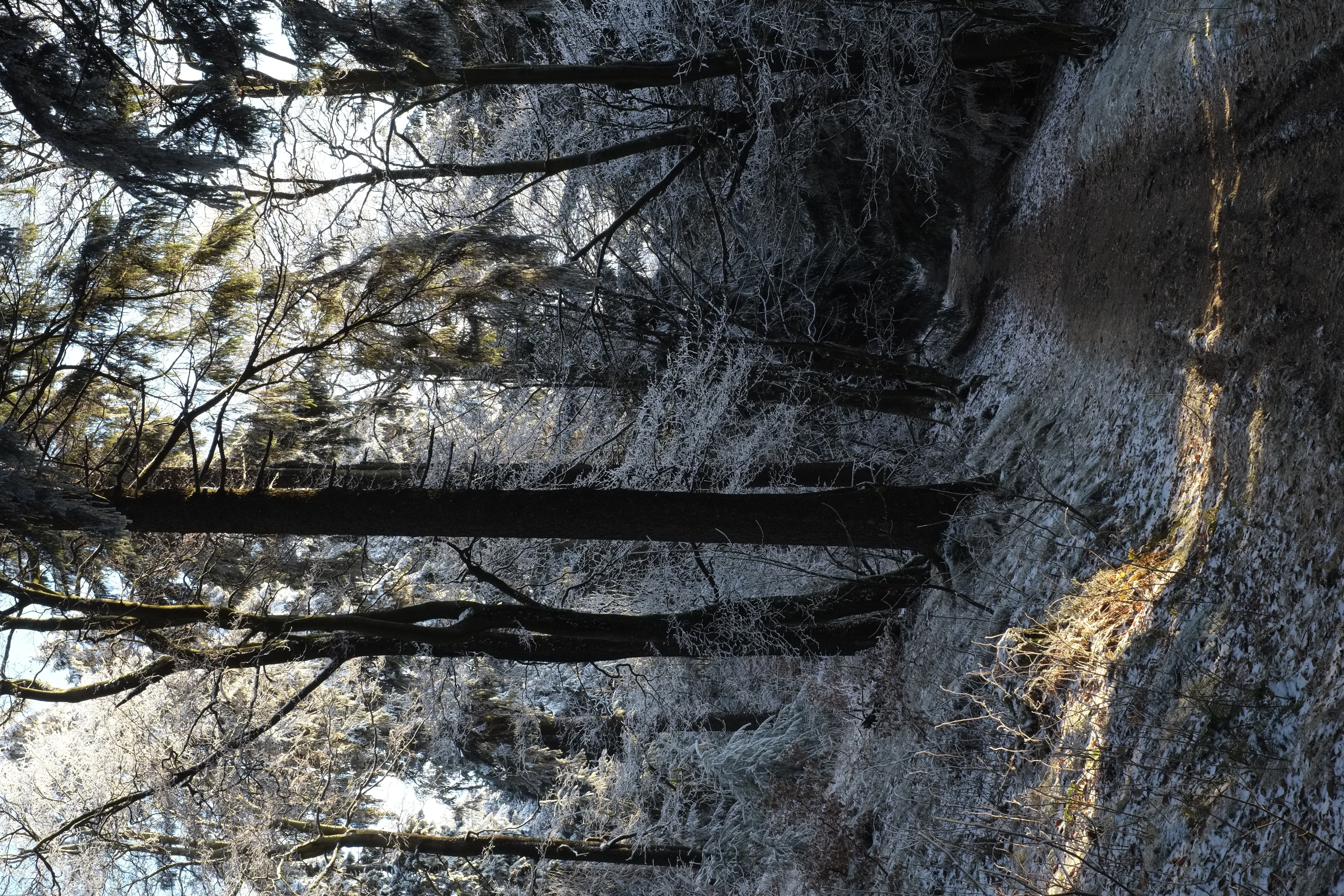

You can download the original Raw files below to try your own processing settings. We've found some improvement can be had by reducing the sharpening but we'd be interested to hear the settings you find give you the best results.
