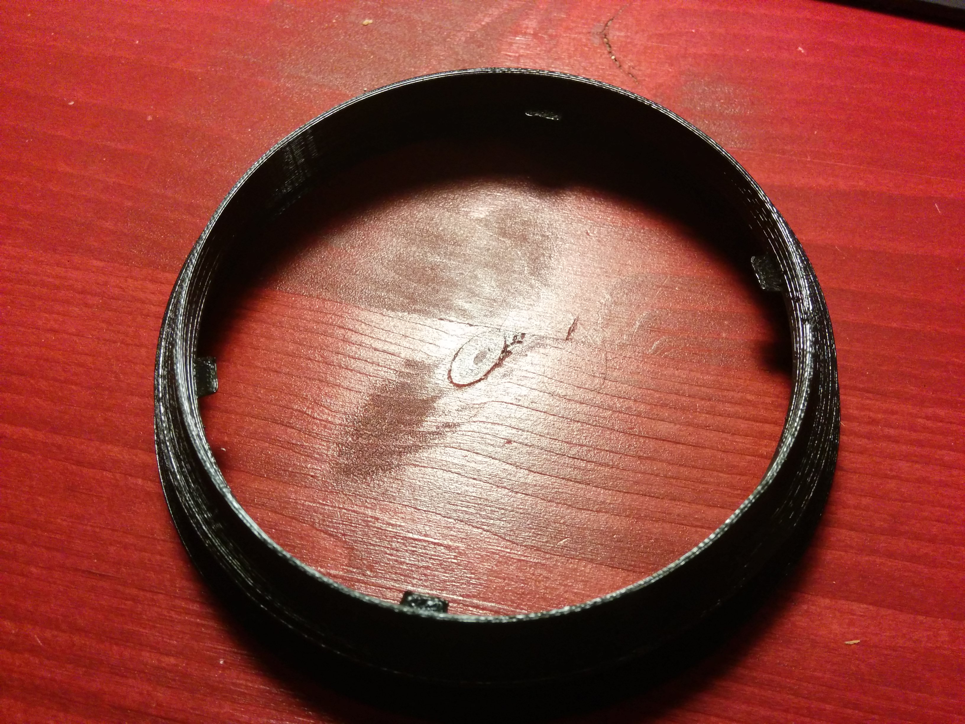

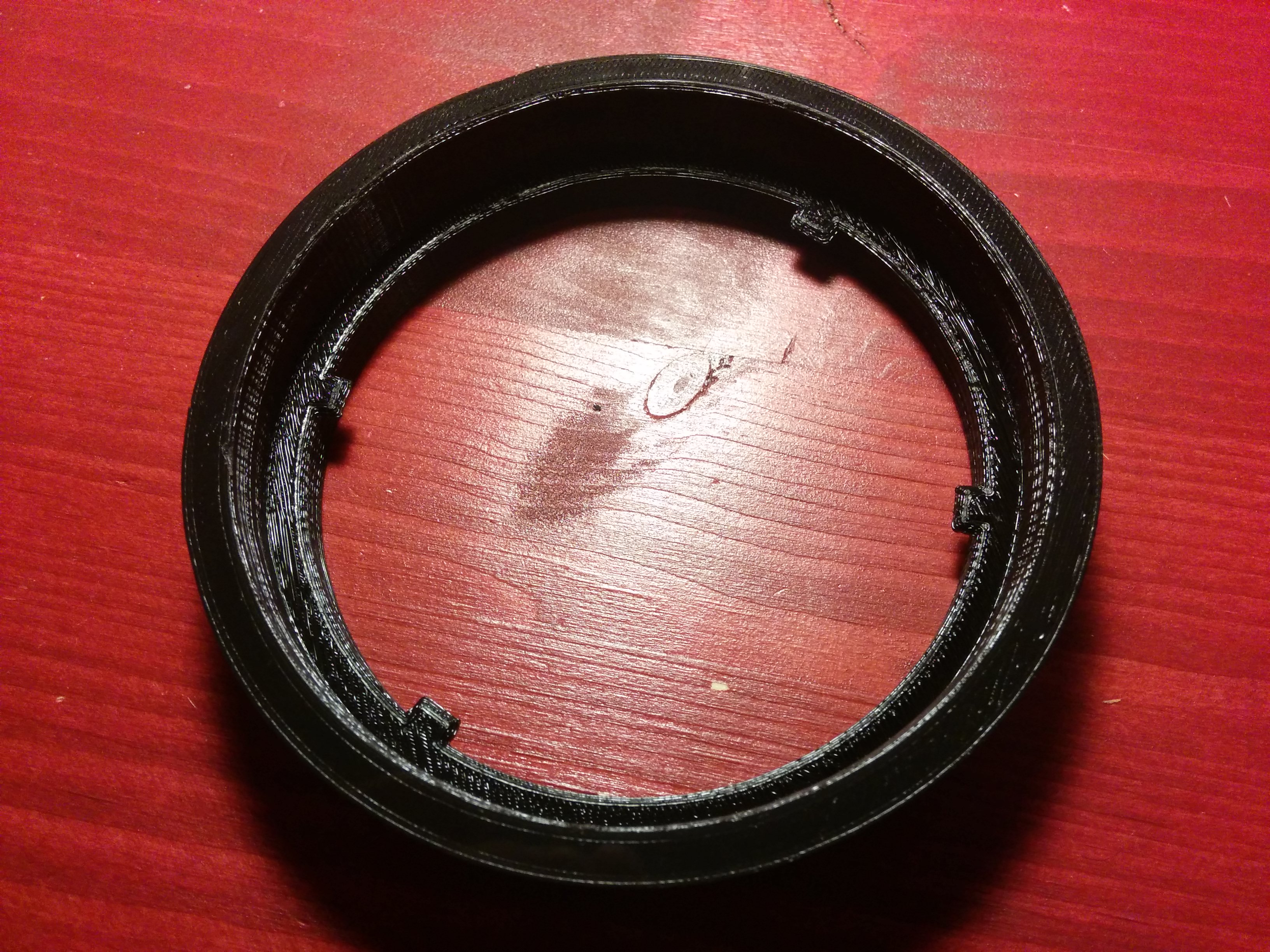

My 3d printed prototype is finished, pick it up tomorrow!
