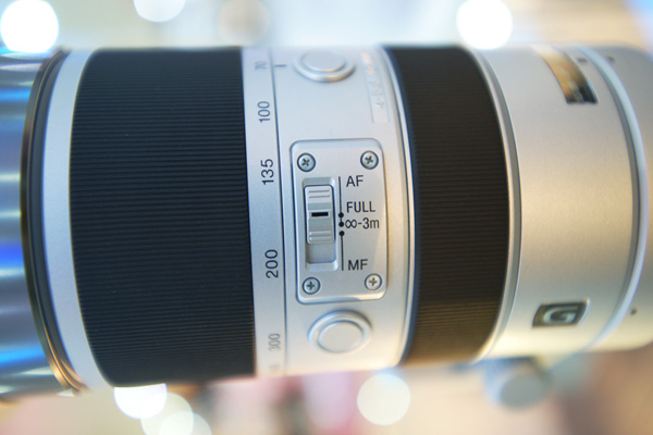

In the a57 menu there is also a function of "focus hold" In the hand book of Sony, it mentioned as "Sets the function of the focus hold button of the lens.
(Focus Hold/D.O.F.Preview)"/ After searching for some time, I think the focus hold button shld be on the Lens. And none of my lens have this button.
Just do a google search I found this :
http://www.sony-mea.com/microsite/dslr/09/standardLens/technology/technology_01.html#fh_button

Yes, this is my understanding too. The "focus hold"-bottom is found on some lenses.

I am 99% sure that the "Focus Hold Button" is on many (but not all, and mostly heavier) Sony lenses. The function assigned to these buttons (some lenses have more than one, so that a button falls naturally under the left thumb in different orientations of the camera) is one of two functions in the camera set-up menu. The two functions are:
  • Stop focussing, and
  • DoF preview (set the aperture blades to the aperture that will be used when the shutter is pressed)
I have set all my cameras to "DoF preview". Unlike Gary Friedman, I use this function regularly to preview DoF. I have never used the "stop focussing" function.
If the lens attached to the camera does not have a Focus Hold Button, the setting has no effect and either of the two possible functions must be effected by other means.

Various high end Sony lenses (70-200G, 70-300G, 70-400G, CZ 24-70, etc.) have one or more focus hold buttons on the lens.
The purpose is to allow you to temporarily suspend AF operation in continuous shooting mode. Say, for example, you are shooting a baseball game in C mode and you have a baserunner at 1st base. Anticipating a pickoff move you focus on 1st base, hold down the focus hold button, and when the pickoff attempt comes you fire off a series of shots. If you didn't have focus hold set, and your field of view was wide enough to have both the baserunner and first baseman in it, your shots would have been focused on the grass behind the players. [Assuming, of course, center spot or zone AF.] Unlike Gary Friedman I use these buttons frequently.
If you don't have the buttons on your lens you can accomplish the same thing by holding down the AF/MF button. This is awkward to say the least, but you can set the button to toggle - press the button once to disable AF, press it again to enable AF.
[You can also disable autofocusing with the shutter button, set the camera to MF mode, and then press the AF/MF button to focus. This is handy for tripod use when you want to keep the focus locked.]

When holding the camera to take a shot, the focus hold button would be near the bottom and to the right of the lens mount on the camera body. You should be able to access it by extending one of your right hand fingers while holding the grip.
On my A55, this button is programmable to be used for Focus Hold (allows you to re-frame your shot without changing focus) or DOF Preview (allows you to check the DOF before taking the shot... since your viewfinder always shows the view as if the lens were wide open, so when using a lens with f/2.8 but having selected f/8 for your shot, you would be seeing DOF as it would be if the shot were being taken at f/2.8 but pressing the DOF preview will show you the DOF as will be recorded since you've selected f/8 instead). The ability to program that button between DOF Preview and Focus Hold may also apply to A77.
Additionally, you may come across some lenses that have focus hold buttons on them. My Minolta 200G has it and so do lenses like Sony 70-200G, 70-400G...

It's the button on some lenses, not the DOF preview button.
In reply to William Porter, Jul 25, 2012
This has been discussed before on this forum. The wording in the manual is unclear, which, I believe, they fixed in later manuals.

Looks like the focus hold button is on some lenses and not on the camera body at all.

That button can be used as DOF (or Aperture) Preview, or Focus Hold, depending on your menu selection.
Some lenses do have that button too, but the manual is strictly talking about the one on the camera body.
