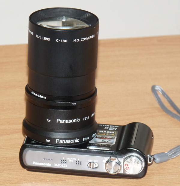

I recently bought a TZ7/ZS3 as a travel cam. As I have several TCs, just to see if it works, I thought I'd try the smallest and lightest of them, the Olympus C180 (nominally 1.7x), on the cam. This was a temporary test rig so I just used available adapters/step rings that fitted around the lens housing and extended far enough to clear the cam lens at full zoom.

Shot of cam with TC:
The C180 seems to perform well, with just slight vignetting in the corners. I measured the magnification as being about 1.6x at this distance (8m). That brought the effective FL from 300mm up to about 480mm (which is similar to the FZ28's full zoom).
The heaviest part of the rig was the metal adapter setup, as the C180 has a lightweight plastic body and weighs only about 80g. Possibly a suitable plastic tube would serve to mount the TC for actual use.
